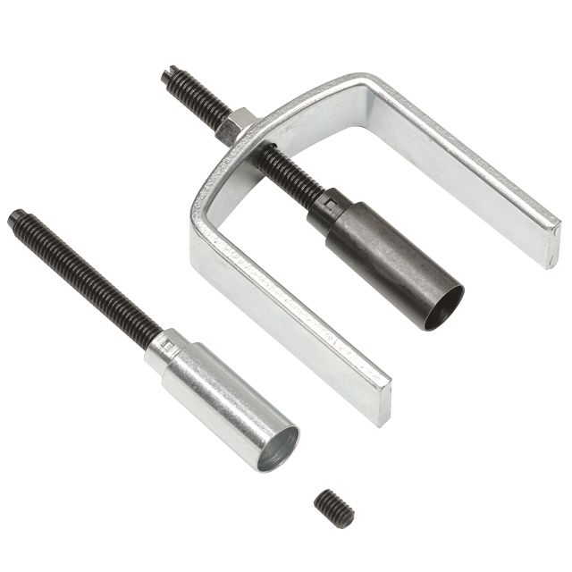

yea, so reguardless, im going to need the special retaining ring removal tool to get further into the steering column.

This is the tool you need to press down the lockplate and remove the retaining ring $20 bucks a sears maybe $10 at a parts store
